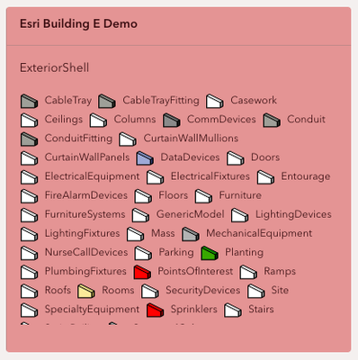

Hi, I'm having difficulty formatting a map legend in ArcGIS ExperienceBuilder.  I've put the legend in card layout with the items and symbols laid out horizontally.  However, I cannot seem to delete the title of the whole legend, and from the title bar to the content of the legend there is a large black margin/padding.  How can I remove this?

The title background color cannot be changed for now - it honors the theme color settings. You can see the title background color changes as you change between different themes. This is designed to ensure your app visual accessibility.
However, I think this is a good point to enhance. Please feel free to reach Esri support if you need this function to be registered as an enhancement. We will evaluate the priority of this issue along the way. Thanks!

The legend title background color has been removed in the latest October 2025 release. You can now change the legend widget background as a whole:
