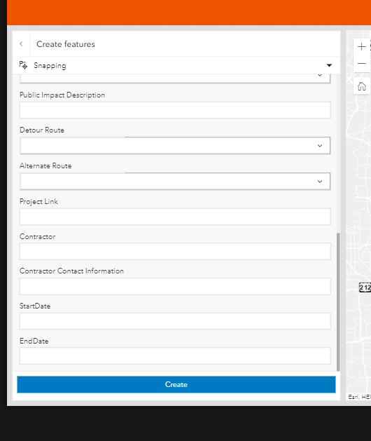

It appears the the Experience Builder Edit widget does not support adding attachments when editing records. Attachments are enabled on my data, but when editing in EB there are no options for adding in the Edit Widget.

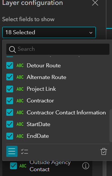

Not in the layer config as a field option:
Unable to add attachments in widget:

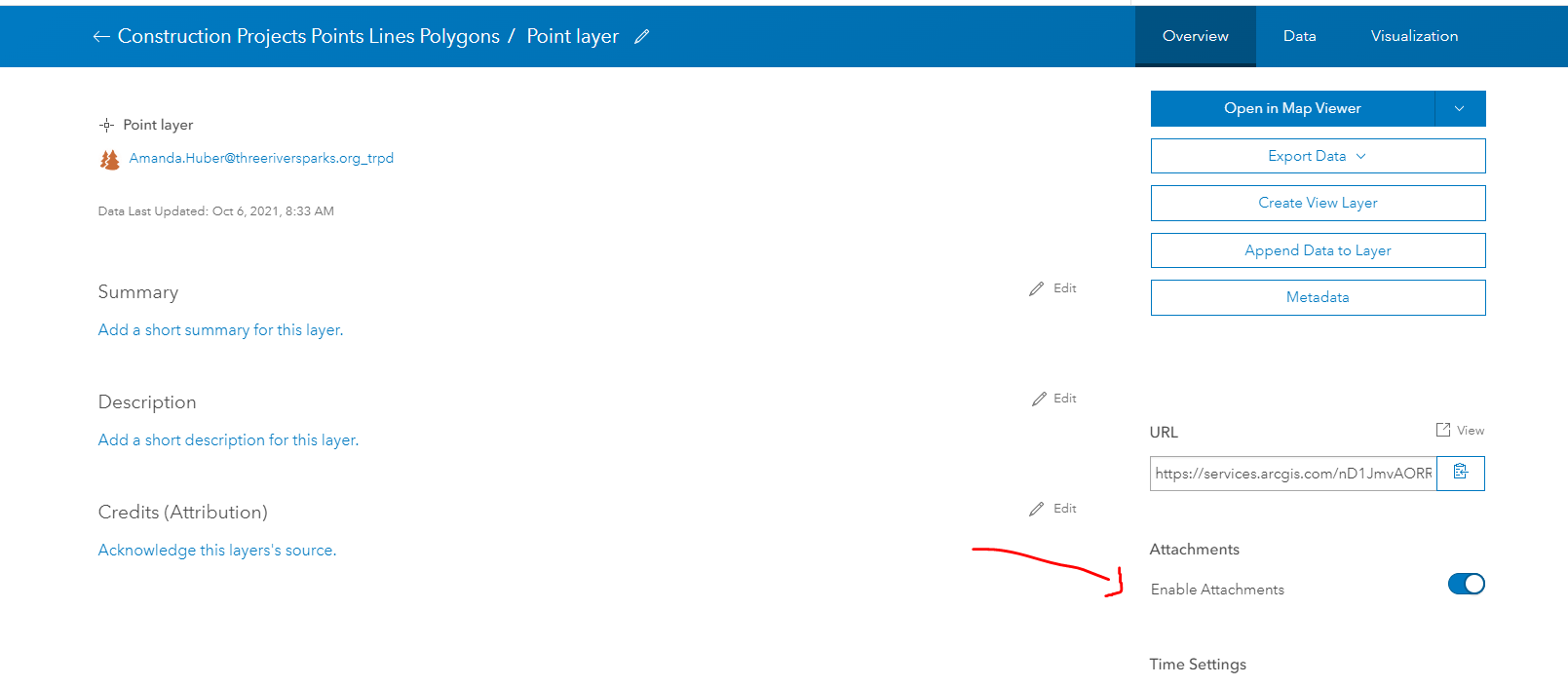

Enabled in our data:
