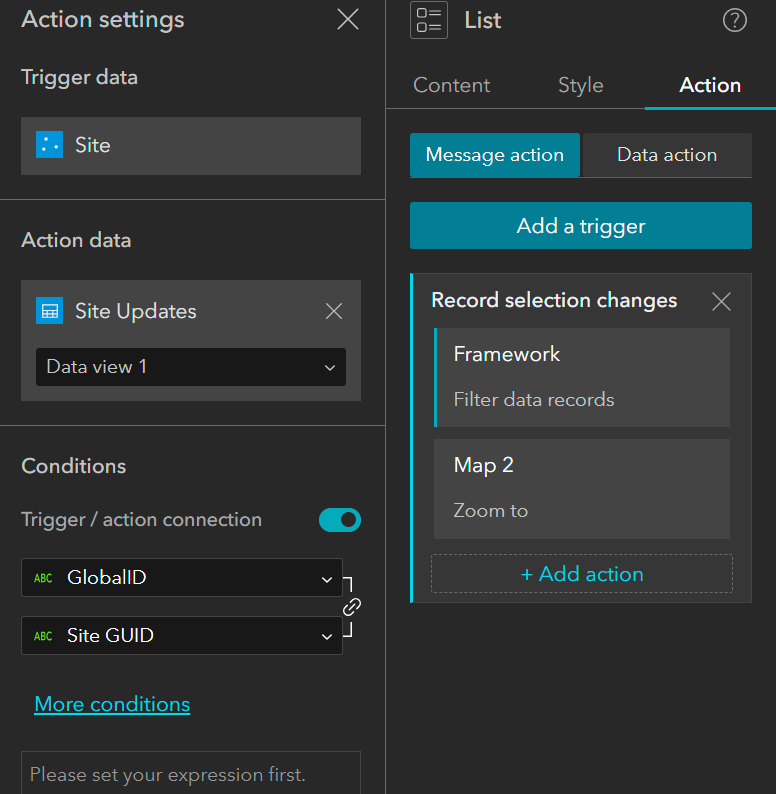

I've been going through the process of upgrading my applications/widgets from ExB version 1.10 to 1.12 and noticed that the out-of-the-box List Widget data action isn't working correctly anymore.
I have two different List widgets, Site and Site Updates which have a 1-to-many relationship, so when I click on the "Site" List it will show all the related "Site Updates" in the other list. It worked great in version 1.10 but not in version 1.12 where now the Site Updates list returns 0 records.
Here is action setup I am using:
I would appreciate any help, Thanks!

We got around to update our dev environment to Enterprise 11.2 that is using this version of ExB 1.12 and I dug a little deeper and its due to the inconsistency of using GlobalIDs and GUIDS as the relationship for the data action.
I'm basically using the "Data Actions" to query related records from a feature to a feature table. I have GlobalDs and GUIDs for the relationship and the internal built query for selecting sites now uses a "LOWER" in the where statement:
Ex:
(((LOWER(SiteGUID) = '{f725dad7-5205-41d3-956c-1b1a45ff680f}')))
Result is 0 records now, because this was programmed for the "AGOL" globalIDs and not the "Arcgis Portal" globalIDs.

Hey @DanJiang, I noticed this has been fixed in the ExB version 1.13 where the change in the query is now like this:
(((LOWER(SiteGUID) IN ('{3b790d55-ac22-4009-b4d2-8960b413b9e8}','3b790d55-ac22-4009-b4d2-8960b413b9e8'))))
So, the query includes have the '}' and without. We just can't use the Experience Builder version that is tied to our Portal.
