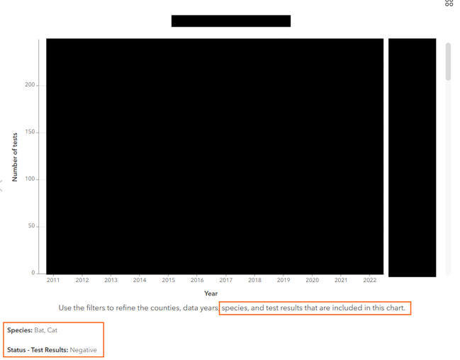

For example, here's a chart that displays the sum of tests by year, categorized by county. The user can filter this chart by county, year, species, and/or test result. The first two variables are already covered in the chart itself, but the species and test result values are not. With the new Arcade capabilities in Experience Builder, I can just print out the species and test result values (filtered by the user) that are contributing to the chart:
However, I'm finding myself already hitting the limit in terms of number of expressions that use $dataSources per page.
