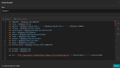

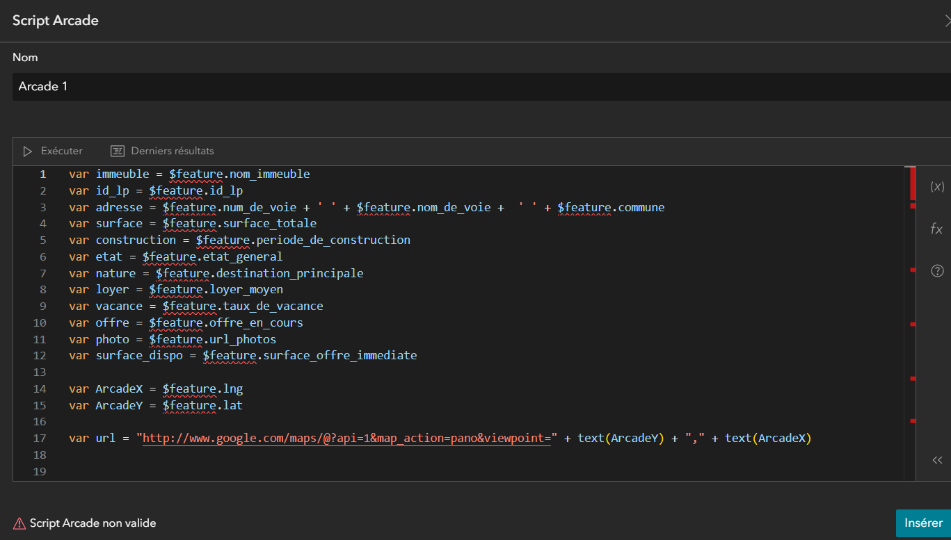

Hi, i have an arcade script who works perfectly on my Map Viewer when i set my pop-up box.
But when I want to integrate the same things on a text widget i have some issue with the "$feature." function :
There is no way to use this type of function ? Or did I miss something ?
Thanks 😉

JasonBOCQUET
So it's impossible in the futur to have the FeatureSet serie of function ?
For your solution I don't really how you do. If I create a list of building and try to create a script who called my offers layers field which is not present in the widget i have an error. And if I create a list of building, create a script with only request about building field, add the offers source and edit my script by adding $feature.field_offers i have an error too.
I want to be able to request on the both sources of data.

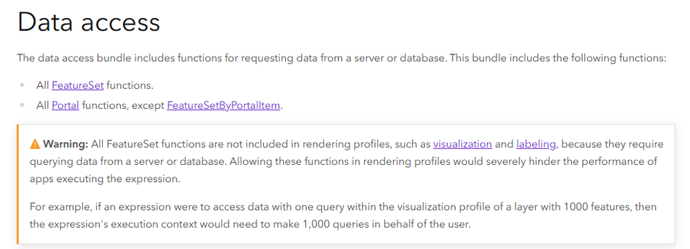

Yes, the $feature variable does not support the Data Access function bundle and cannot be used with the FeatureSet series of functions. This limitation is also documented in the Data Access documentation:
When using a list widget that displays multiple features, the same limitation applies. Each feature is evaluated individually. This means the expression could trigger multiple simultaneous queries. This can lead to performance issues or failures.
My solution is to remove the $feature variable block when the text widget in the List is connected to multiple data sources. However, $feature simply does not support the FeatureSet series of functions.
