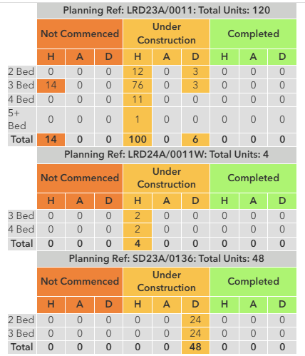

Any one else experiencing issues with both distinct and filter functions since the last upgrade. Both the samples below were working perfectly then there is an upgrade and they stop. I cannot find any documentation saying they were due to change or be discontinued its baffling.

Its all up on AGOL so whatever they did last week, didn't have time to investigate it until now because I was fixing other stuff that broke, The error for what its worth is Test execution error: Encountered unreachable logic. Verify test data. Debugging arcade is slow and tedious but found I was getting no return for the distinct so rewrote that section and then I discovered the filter was not fiving a return either so will have to rewrite that section as well. I always thought that the idea behind documented built in functions was that they worked consistently and you got warned about depreciation.

After a fairly substantial rewrite to add in a distinct and filter outside of the functions it is back working again. Does this actually need to happen from my viewpoint ESRI pushed a release out early  in order to wave their shiny new toys at a user conference. We all like new features that help to make work easier but please stop breaking stuff that was working and maybe try a little testing before you do push a release.
