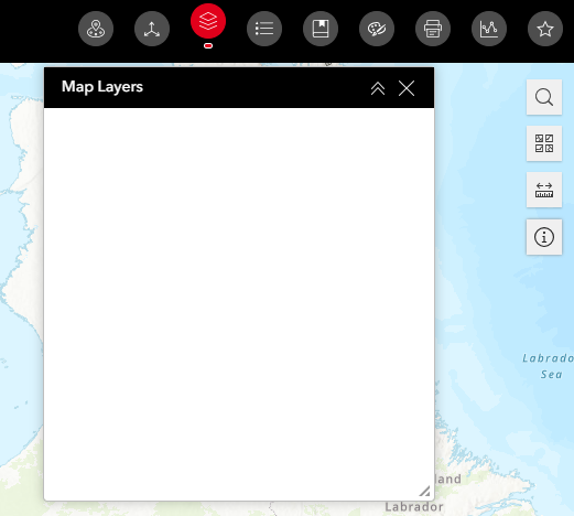

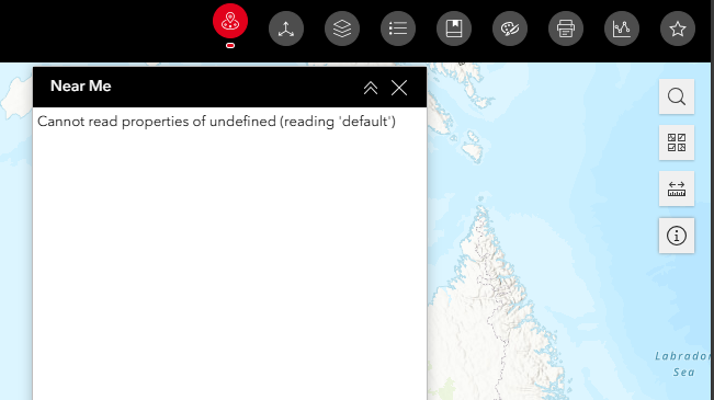

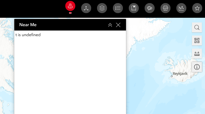

For myself, one of our main Experience Builder solutions only seems to function in Chrome, not Firefox or Edge. On Monday, it wouldn't work in any browser. Since the issue was marked as resolved, it seems to never work in Edge, sporadically or partially work in Firefox, but seems to consistently work in Chrome.

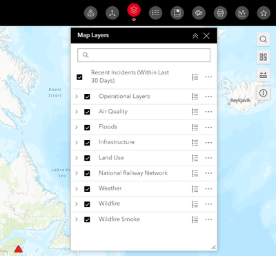

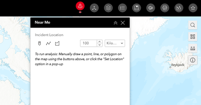

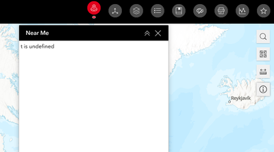

The Experience has a toolbar at the top. Looking at two widget as indicators (layers and near me), all seems to work in Chrome; layers sometimes work in Firefox but near me never works; and no widgets work in Edge.
Chrome - All is good here (though performance is still slower than before Monday)
Firefox - Layers seem to work but Near Me never does
MS Edge - Nothing works!

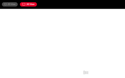

In addition to the standard WebMap, I have a WebScene as part of the Experience which isn't loading at all in any browser! It just has the endless loading animation on screen. Note that if I open the WebScene itself, it works just fine, but it does not work as part of the Experience.

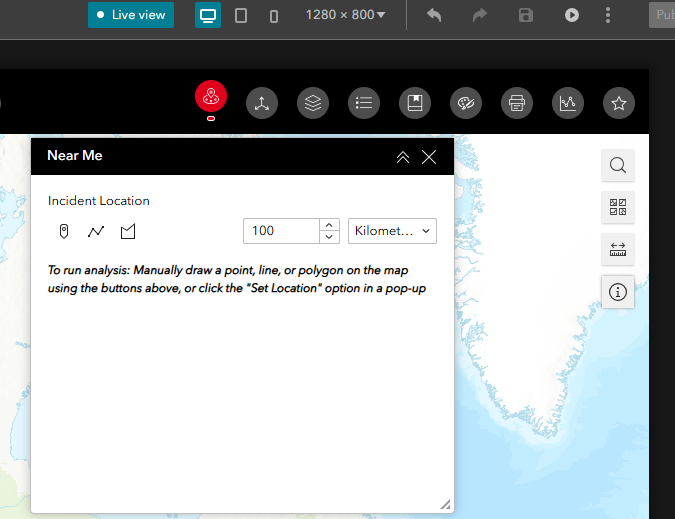

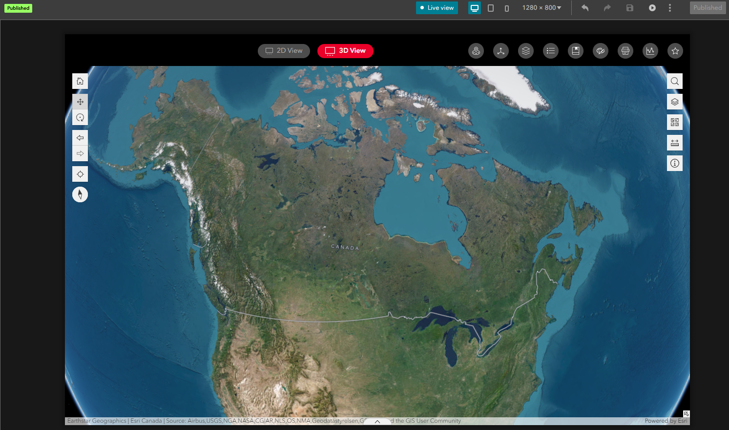

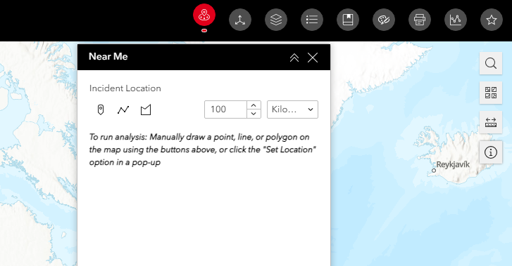

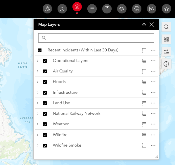

Interestingly enough when I try to edit the actual Experience, everything works as expected, even in MS Edge. This includes all widgets + the 3D view. Basically it works as it did before the service disruption on Monday. However in the actual live version, things decide to stop working.
Functional 3D view - MS Edge while editing the Experience
Functional Near Me widget - MS Edge while editing the Experience

Regarding Chrome, I kept having issues with the 3D scene not loading. This was due to user error. A solution for a separate issue was to turn off graphics/hardware acceleration, however 3D scenes cannot load with that option disabled. When the embedded scene tried loading, it returned a constant loading symbol. However, when launching the scene on its own, the error message that a scene cannot be opened without utilizing hardware acceleration appeared. Once I turned on the option again, the embedded scene worked.

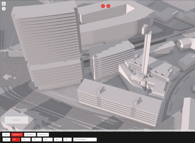

ncatunda

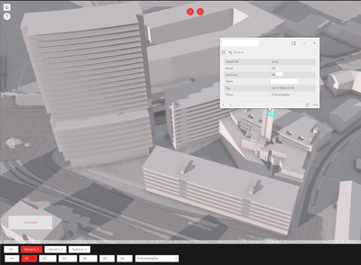

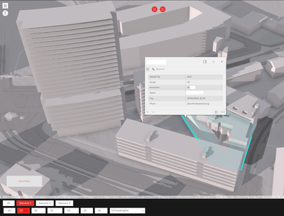

I'm wondering if that might be the issue I'm experience with the filters not complying with the requests (only if I try to filter the same layer for two different fields).
It does not work in Edge, Chrome, Brave and Firefox.
It does work in Safari.
Context: I have scene viewer with a multipatch layer with fields related to the variants (01 to 06) and to the Phase (Zwischenbesprechung - Midterm and Schlussabgabe - final delivery). If I use one of the filters, either the variants or the phase, the filter works just fine. But if I use them together with an "AND" clause, all of a sudden the filter does not comply completely. And that is the strange part, it kinda complies partially but some features just appear and I don't know why. I already tested the rest API and the queries are working fine, there are no mixed features, that is, features it shouldn't be appearing because they should have been filtered out. So there is some issue with the browser with the filtering that I don't really understand. I also tried to do one filter then using the list with framework action (filter data records) and exactly the same issue with the same geometries reappears.

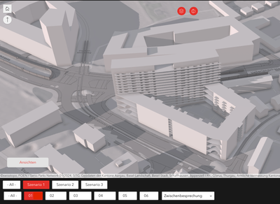

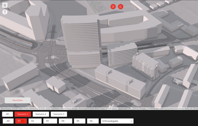

Here is how it should be:
working on Safari for both phases, example of one variant.

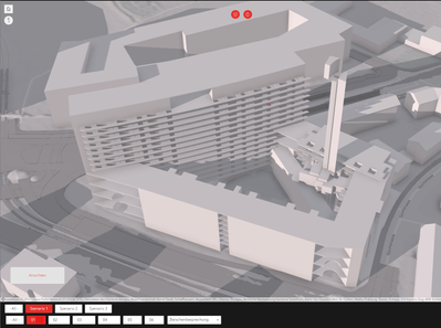

Here is how it appears in the other browsers:
Do you see the random geometries mixed in the middle?
Here there is some feature from variant 04 appearing when variant 01 is the one actually selected.
Here is not only the variant wrong, but also the phase.
For all the variants and the phases, it always the same geometries not complying.
Does anyone has an idea?

So in my case it was an issue with the layer (not sure if the feature or scene layer).  Not sure what actually happened that the double filtering would just not work (I did rebuild the cache). The issue was consistent in different browsers (and I'm almost sure in different computers). My solution was to make a new layer exactly the same and this time it worked without issues.
