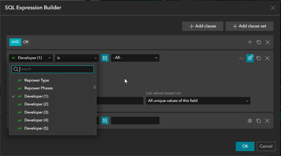

So I want to make a query or filter widget in experience builder that has one query for multiple different attributes. For example in my data certain projects have multiple developers. IE: Developer (1) to Developer (5):
And in the different developers there may be matching developers, so "Developer X" lets say could be listed in Developer (1) as well as Developer (3), So want to do one search for all those different developer features I have. I was hoping I could maybe paste in a custom sql expression but looks like that is not possible.
Would be very nice if we could allow for custom sql queries so we can use the filter or query and do one query on multiple attributes.

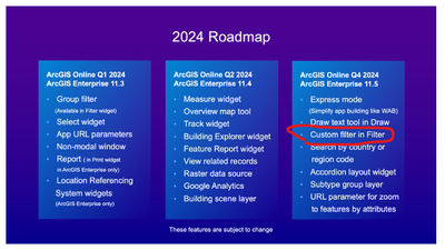

End user defined filters are coming in the next update.
For now, it is possible for end users to build custom filters in a number of widgets including: List, Map Layers and Table.
If you are looking for an option to type out your own SQL queries, instead of using the SQL Builder, I don't anticipate that happening.

Re-reading your question, here are two possible solutions for the query you are trying to make.
  1. Create a clause set with the OR connector. Make a series of clauses like Developer 1 is Jim, Developer 2 is Jim, etc. This should find Jim in whatever field he is in.
  2. Add a new calculated field to your layer called combined_developers that combines the values of all of the developer fields into a single comma separated list. Then use a filter like combined_developers contains Jim, (include that comma in case you have a different developer called Jim Harper).
I would go with the second option.
