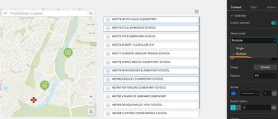

@KitKat94 One way you might try is using the List widget. In the State/Selected/Select mode, you can change it from the default Single to Multiple:
With that, you can select the desired feature records and export them. One downside is that the users might need to play around and familiarize themselves with the data to know which record in the list is what they want from the map.
