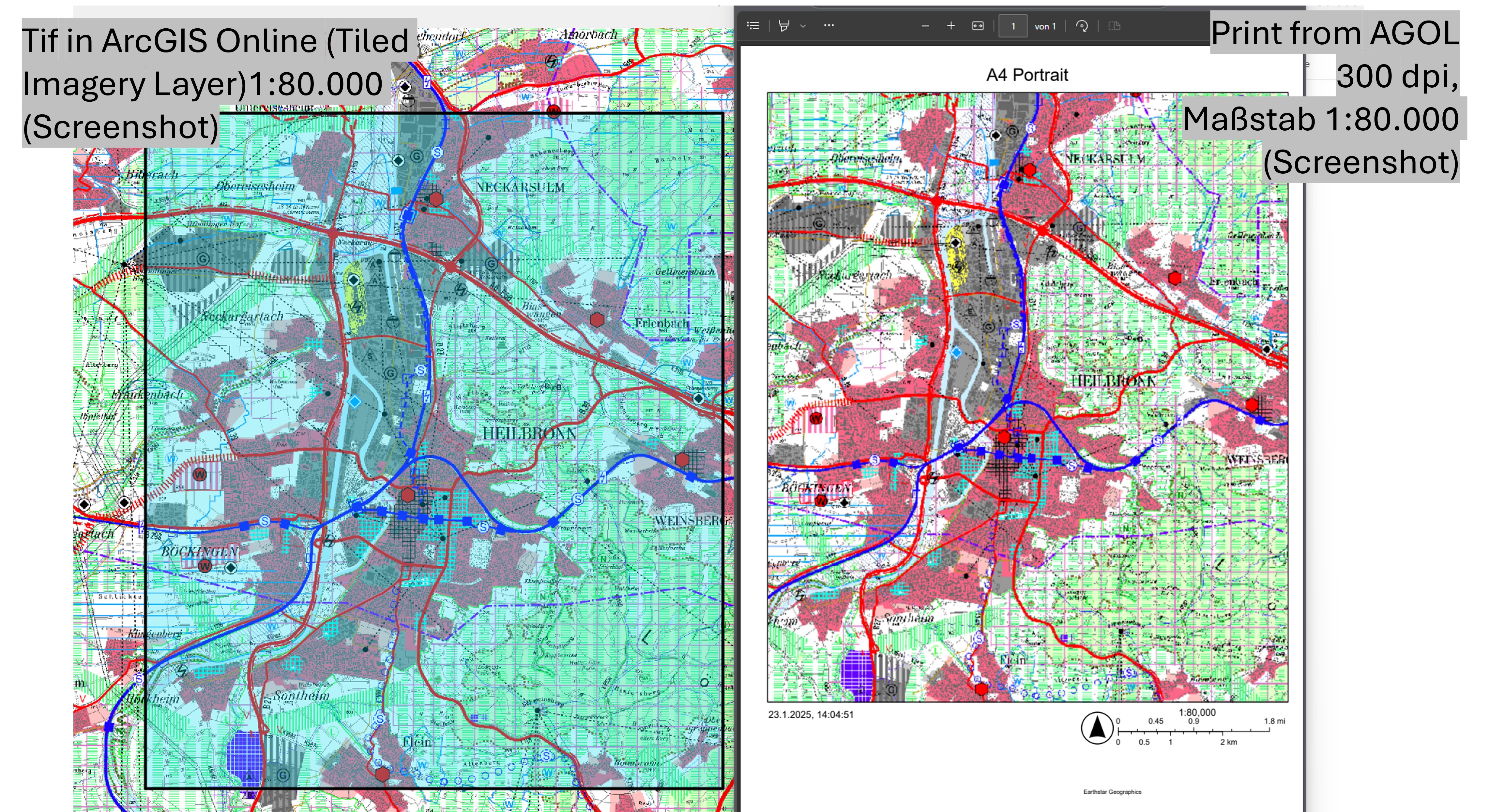

I published a 10 km² image (800 dpi, tiff) of our map in the experience as a tiled imagery layer, because we are not allowed to show our vector files to the public. To get information from this raster, I published our vector files as tile layers in the background of the raster, so that the vectors stay invisible, but anyone can get their information by clicking on the map (pop-up).
This works fine, but I have issues regarding printing pdf-exports of the map. For us it is crucial for the user to be able to print any part of the map in a scale ranging from 1:80000 to 1:4000. For this I am using the printing widget.
The problem is that the quality of the result is very bad (see pictures below).
I tried to upload the imagery tiles by exporting the tile cache as .tpkx from Pro and the resulting quality got a little better, but it’s still not good enough. I know that the images uploaded get set to a dpi of 96 but I do not know how to improve that.
