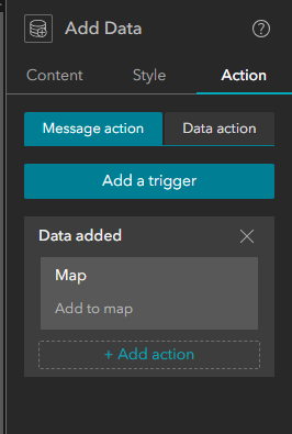

Using an Add Data widget in Experience Builder in AGOL, is there a way/setting to have the added data automatically show on the map, without needing to go through the Actions menu? I only have one map so it's pretty obvious that I want the data added to the map ... and want to make it as easy as possible for my users. Thanks

If you go to the Actions Tab, you can add a Data Added > Map > Add To Map Action.

From what I understand, that just allows the user to add the data to the map. They still have to go to the Actions Tab and select Add to Map. I'm hoping that as soon as they select the data and click 'Done', that the data is added to the map straight away. To me the extra steps via the Actions Tab seem pointless, at least in all of my scenarios and I'm trying to minimise the number of clicks for my users. Have I missed sometihng?

Go try it out. It works exactly the way you describe.

Oh sorry I missed it being in the Message action tab rather than the Data action tab. Works great, thanks again Jeffrey
