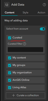

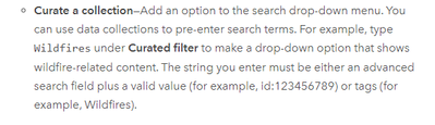

You can curate collections using the Add Data widget. Please refer to the documentation here. Notably, you can always drag and drop the curated collection to the top.

Thank you for the response, my client is only at 11.1 right now. I'll tell them they will be able to use it if they update.
