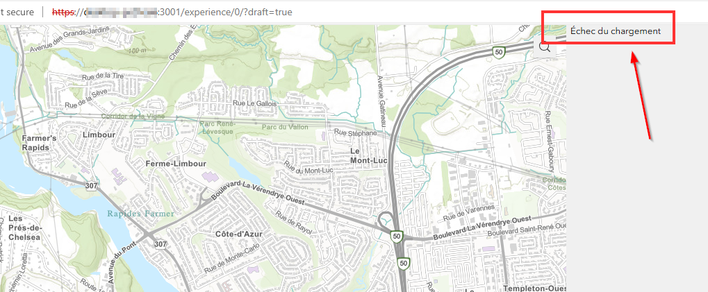

Bu when I reload I get this (failed to load)
I am stuck there... any creation of any object will give me that problem ( const xyz = new Whatever() )
the function is not event called anywhere in my code at this point.

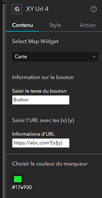

Hello @Brian_McLeer here's the small widget I made.
The widget is called xyurl
The setting needs a map, the text for the button a url ({x}{y} will be replaced with the actual coordinate one you click on the map) and the color of the pin on the map

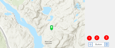

in runtime
(1) click the cross and the the map (the pin will appear)
(2) the you can click the button
(3) click the trash can to delete the pin
