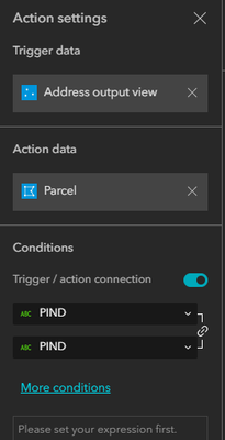

stariq22
https://experience.arcgis.com/experience/4d2e8ef6b21343ddb243894f58df94f3
When you conduct a search using any specific address, such as 950 S Magnolia ave., you need to double-click on the search result for the pop-up to appear and the parcel to be highlighted. This is under the functionality of our search widget, which has the 'Auto select the first result' option enabled. Prior to the February update, this feature would automatically highlight the parcel and present the pop-up without requiring a second click. Our address search is using a custom locator and below is the screenshot of the action:
