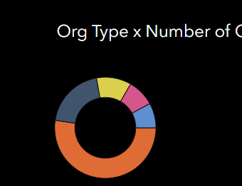

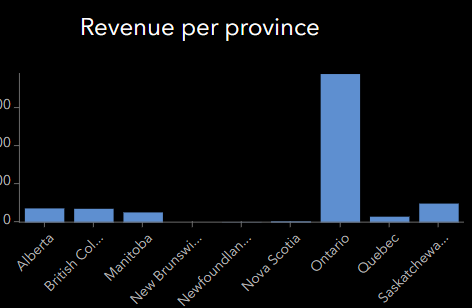

  • bar chart of revenue x regions (eg., provinces)
  • pie chart of counts for different types of clients
            3. Ideally, then I could click on a slice of the pie chart and it would then filter the bar chart to show only revenue for that specific type of client in those geographic regions (or vice versa)

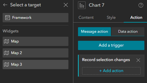

But I am unable to action the pie chart to the bar chart or vice versa to complete the last step as I don't want to action a particular map, and when I try to use the framework to set the trigger/action data appropriately, I get stuck since they now don't have common fields (that work, it doesn't work when I use OBJECTID for both).

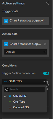

@maya_fromstein , to filter the bar chart rendering by pie chart selecting, you can do this.
1. Select the trigger data as "chart output of pie", action data as the "input data of bart chart".
2. At condition, please do not use "OBJECTID", because it is just id of each dataset, but it is not the same in trigger and action data, although with the same name. I know it is confusing but the "OBJECTID"s you were using are not the same attributes, so it won't work. You should use "Org_Type" as the connected filter now.
Take my data as example to show you the config.
Bar: population of each state
Pie: count of area class (city, town or village etc.)
Note that the action data is using the input of bar chart, not the output of bar chart
