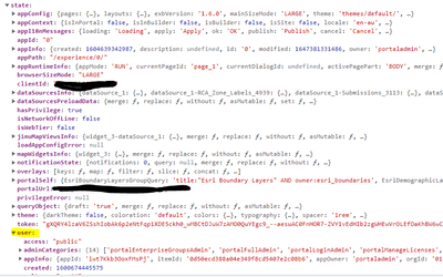

The state object has the details of the logged in user. eg
