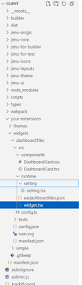

Your file structure is incorrect. The setting folder must be directly under the src folder. Experience Builder is highly opinionated and will not find files or folders if they are not placed in the correct place with the correct name.
I have not reviewed your code closely, so there could be other issues as well.

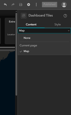

Finally, Map option appeared, there are two options , none and map and i have selected Map, and now i have the map object in jimuMapView (state variable).

Finally , Map option appeared in setting panel of the custom widget, and now I have map object in jimuMapView (state variable).
