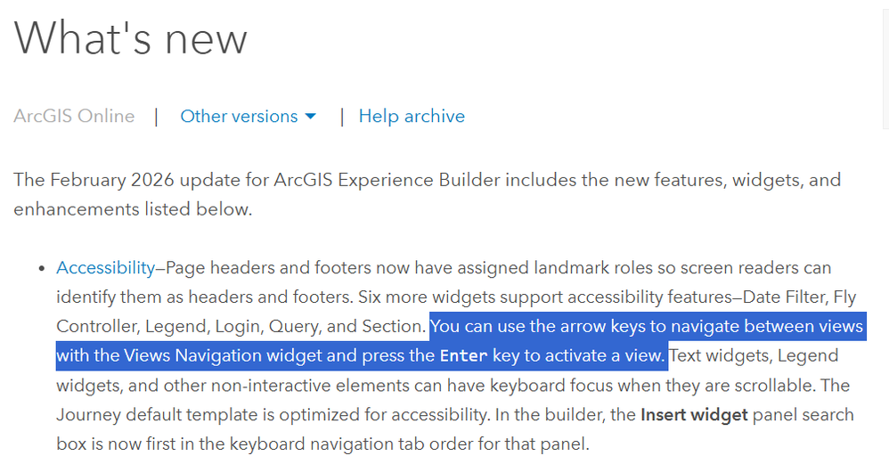

The text scroll issue should have been resolved with the latest AGOL 2026 Feb release:
 Non-interactive elements can have keyboard focus when they are scrollable, such as a Legend or Text widget without links.
Let me know if you still encounter other issues. Thanks for bringing this up.

Hello @TonghuiMing thank you for your update! I got my case notification that it was resolved and I believe I was able to confirm that we were all good (hidden element 9 being the biggest issue).
I did notice too, if you can confirm, that the keyboard shortcuts work a bit differently now. When there's a section and headers, instead of tabbing from one to the next, I had to use the right and left arrow keys. I believe that makes sense to me!

Yes! That was one of the updates that we have too - what's new in the 2026 Feb release
And yes, we believe that it makes a bit more sense to mimic the HTML Tabs behavior for these views navigation purposes, which gives a quick navigation into the active section right now, instead of tabbing all the way through the nav before going into the actual section view.
