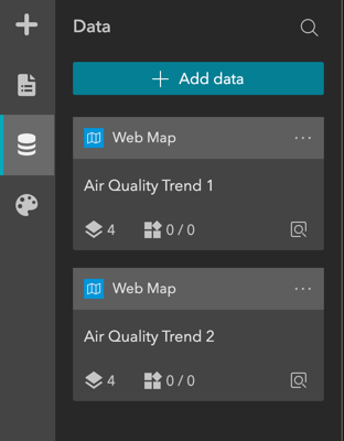

@AFackler_NAPSG @TommyDSM and all, you can add the same map multiple times to the Data Tab in Experience Builder as separate data sources. For example, the Air Quality Trend map is added twice to the Data tab as two web maps which is then renamed to Air Quality Trend 1 and Air Quality Trend 2 respectively as shown below. Click each web map, turn off /on the layers in the map data source as highlighted, then use Map widgets to connect to each map data source with the layer visibility defined in the above step. In this way, you only maintain one map with multiple map data sources.
