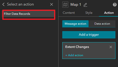

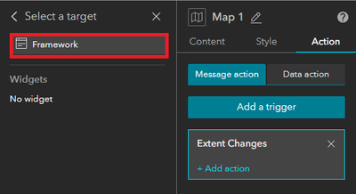

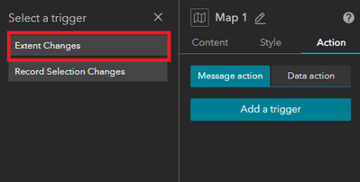

1. Add an "extent changes" trigger to the map widget
2. Make the trigger target the framework
3. Set the action "filter data records"
4. Select the data you would like to use
Then you should be able to filter the table records by navigating/zooming the map!

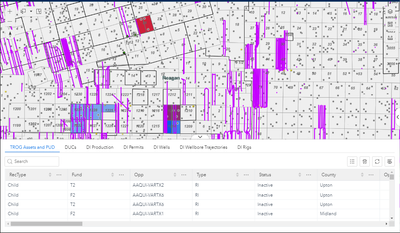

Thank you @TianYu ! However, I have already done this. It is filtering my text widgets, but not my table.
In this example I am zoomed to Reagan County ONLY, and Upton and Midland (as well as all other data) are still showing. Do I need to update somehow? I reviewed all my triggers and they are done how you suggested.
