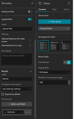

JeffreyThompson2
There is an option to sort the query results. All the way at the bottom of the Set Query Panel expand the Results and Add a Sort Field. However, turning this sort on and off is not an option for the end user. I also tried testing having an ascending and descending sort on the same field and the query errored and returned zero results.
CameronLacelle
@JeffreyThompson2 ah thanks, I did not see that at all. Seems to not be super reliable so I'll likely leave it unsorted on our application for the time being. Esri really should implement when a query is run, the end user can choose to sort ascending or descending by the queried field(s). Unfortunately, there are a lot of back end customizations that make zero sense, should be available for the end user to control and aren't at the moment, or don't work as intended.
