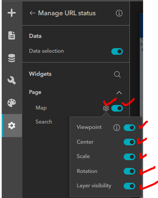

AlexErnst_IDPR
This appears to have been resolved. Kudos to the Esri team.
When the EB version of the Share Widget was created, apparently a great deal more power was built in to define parameters in the URL, but those settings need to be turned ON in your EB project-- they are OFF by default.
ChrisChappell1
@AlexErnst_IDPR Thank you so much! I've been waiting for months for this to be implemented and never thought to look for the settings there.
