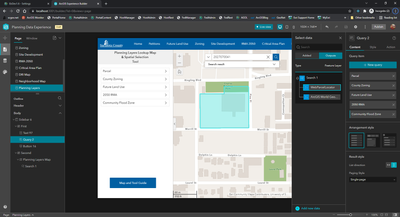

Hi @ShengdiZhang  - I'm sorry but it's just not working.  Perhaps because the layer source output is from a polygon feature layer?  Here, you can see that I have a layer source set in my search widget, and the search does in fact return the selected record as graphic on the map:
However, the feature layer (or it's result) continues to not be available as an Output for consumption by the Query widget:
I've been working on this off and on for months.  The screen shots above are from the developer edition 1.7.  But the same behavior exists in online.  If anyone has any ideas, that would be great.  Maybe @Jianxia or  @RobertScheitlin__GISP  ?

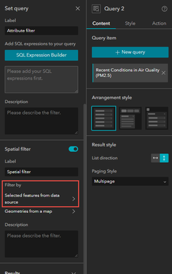

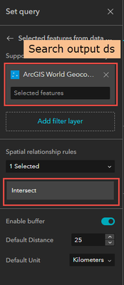

Currently, only the query widget supports the spatial filter. Here is a workaround using the search and query widgets.
Please see the following steps:
1. Add a search widget, and add the locator service as the search source
2. Add a query widget, and create a new query using the data with cadastre property
3. In the Set query panel, under the Spatial filter, click the "Selected features from data source". Select the outputs data source from the search widget as the filter layer.
