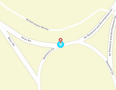

I am having the same issue.  I need a symbol to display at the center of the map when returning the result of an address search using an address locator.  I am using Experience Builder 1.14. and would like to display something like this (any symbol is better than nothing).
Currently, I don't have any symbol that displays as the address location.

Thanks for the quick response.
I am trying to display an address referenced by an address locator.  There is no actual point data that is being zoomed to.  Can address locator results 'show on map' the center of the 'zoom to' when point features do not exist?  The previous screenshot is from a different map viewer that displays the geocoded address, not an actual GIS feature.
