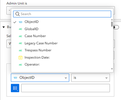

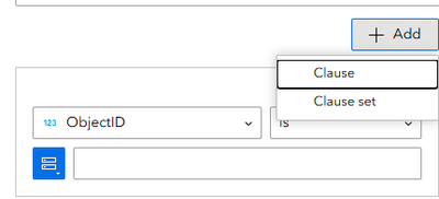

AlfredBaldenweck
Can't you already?
ZachBodenner
This is probably dependent on which version of Enterprise you're using. By design, Enterprise releases lag behind AGOL, so if you're using the built-in ExB in Enterprise you will be some or many versions behind. Custom (personal) filters were added in...1.15? 1.16? I can't remember specifically. It's likely that you just aren't upgraded far enough yet. What version of Enterpise are you on?
