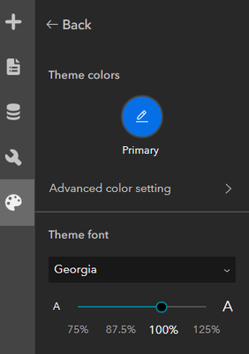

1 - The way is to change the font inside the Theme editor, and it affects all places inside the builder:

1- That works.

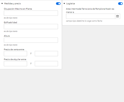

2- I should have put a picture. I have set both filters with a pink fill. Behaviour is different.
3- What I expected when setting up a vertical filter of 100% height was that it would fill the entire length of the section. In pink we can see that it does not.

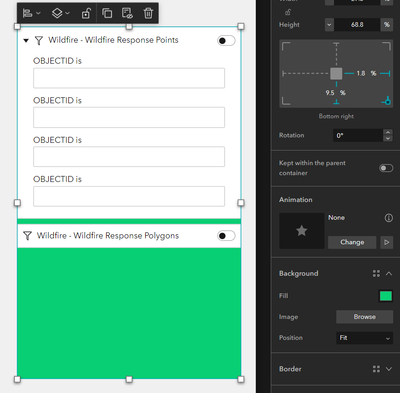

TonghuiMing
@JavierMadoz1 - Yeah, for 2 & 3, the filter panel height depends on the actual content height (how many filters are configured) instead of a responsive height (fill/stretched scenario). The first one shows the background because the content height is smaller than the widget container height, while the other is the opposite.
