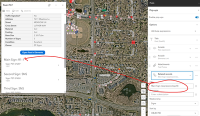

In the Editor widget in Experience Builder, there is an ability to add related records, which is great. But once you have added multiple related records, it gets confusing because the title of each record uses the name of the related layer or table. It would be helpful if you could have a dynamic title for each individual record so that you can easily distinguish between records when you are editing. Related_Record_Title.pngRelated_Record_Title.png

Are you unable to set the title in the layer/table itself and have that work as the individual name?
edit to add: I ask if 'unable' because related records have gotten short shrift over various product rollouts, so it's possible you're using a version where that isn't honored.

You do have control over what's used for the title for each related record; it's the form title for that related table.  You do this in Map Viewer, by selecting the related table in the Tables list (on the left hand toolbar) then on the Right hand toolbar, clicking Configure Editing > Forms.
Create a form and set the title - you can use field replacements with it as well.
