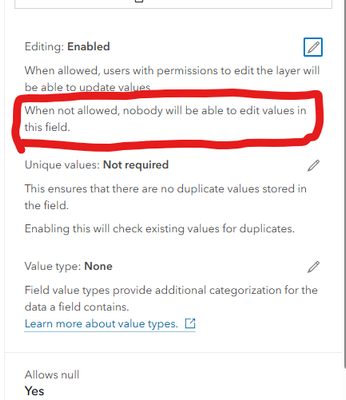

@KenBuja@Bud I did some minimal testing but this appears to lock it down even for owners:
In AGOL go to the data tab, click fields, select the field you want to restrict and disable editing.
Looks like it just applies to AGOL Host Feature Services.
