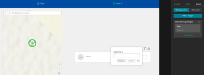

Here are screenshots of the Action items for the List widget currently:
The "Data filtering changes" action only allows you to choose Map and either Pan to or Zoom to.

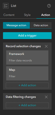

This is what I would like to see be the options for "Data filtering changes" > "Map" >

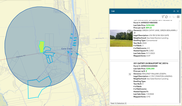

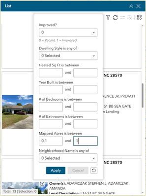

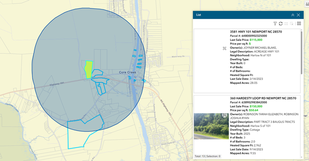

@TonghuiMing Yes, the filtering works in the List and will zoom or pan to on the map (if I add that action), but that is not what I want to happen when I filter the list (see images below). I want the mapped Near me results to show the filtered list results.
List Widget > Actions > Add a Trigger > Data filtering changes > Map > Filter
Results from the Near Me search.
Filter tool within the List Widget.
Results from applying the Filter tool in the List Widget. As you will see, the List records went 13 to 3, but the map still shows all 13 from the Near me search.
