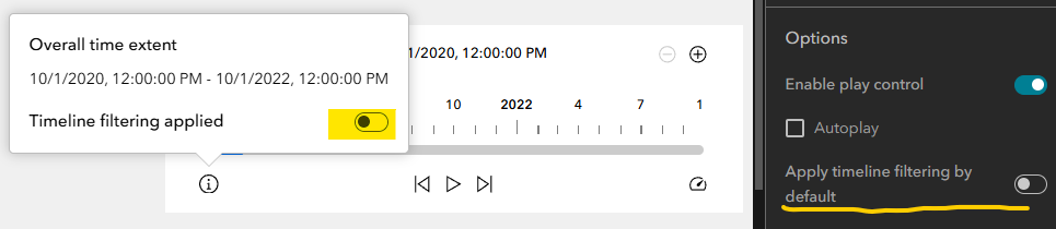

TonghuiMing
The option of "Apply timeline filtering by default" has been provided in the recent AGOL 24 Nov release:

Goldendelicious
"Additionally, it would be very useful to have the capability to set the timeline to a specific date or date range by default."
THIS. 1000%. I want timeline filtering in my app and for it to start by showing All the data in the timeline by default. And then to progress through time by a given amount (ie: 1 month, or 1 year). But both of these things are not currently possible in an intuitive way. The closest I can get is set the timeframe as 1 giant chunk that encompasses the entire timeline. This solution makes "time steps" (using the timeline play button) pointless since one jump in time is the entire timeline.
And while I do appreciate the "apply timeline filtering" toggle being implemented, it is not in an intuitive location (behind the "i" button), nor is it obvious what it does to an average user.
