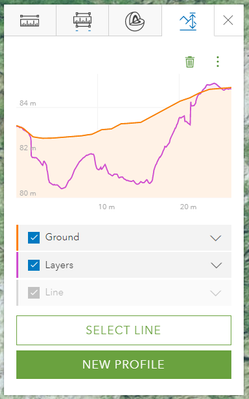

It would be great for the Experience Builder Elevation Profile widget to have the same functionality as the 3D Scene viewer Profile tool - the ability to see separate profiles for other 3D layers in the scene such as 3D scene layers/mesh surfaces.
This is really useful to be able to see the difference between the ground and any changes that might have taken place since in the mesh layer.

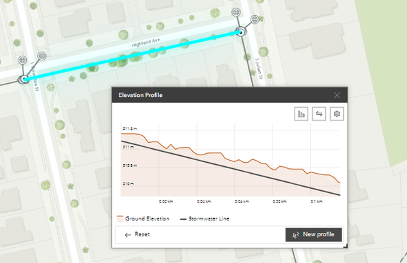

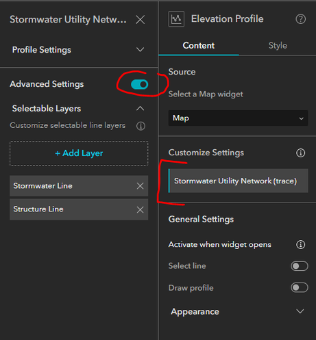

@AndrewDouglas-Clifford1 This is currently available in the Advanced settings of the widget. This should work as expected for both 2D and 3D maps.
Is there any further functionality you are expecting related to this?
Also, do you see anything we can improve to make the settings for this functionality standout more?

As I understand it, that setting applies to selecting the geometry of an existing line feature, and using that as the profile line (compared to drawing a profile manually). That is useful, but not what I was after as it only supports line features.

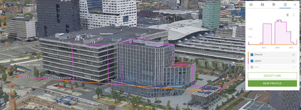

Is this a good example?
Digital Twin - 3D-mesh Utrecht (Kavel 10) met SPOTinfo PandenPlus
@AlixVezina yes that's pretty much what I'm after, thanks!

@AlixVezina @ChrisFox We need this! We need the elevation profile to show both the ground and buildings, exactly as in the 2nd example from AlixVezina. Very disappointing that ExB elevation profile is not as good as the one in 3D scene.

AlixVezina
Status changed to: Implemented
This was added to the Elevation Profile widget in the February 2023 update.

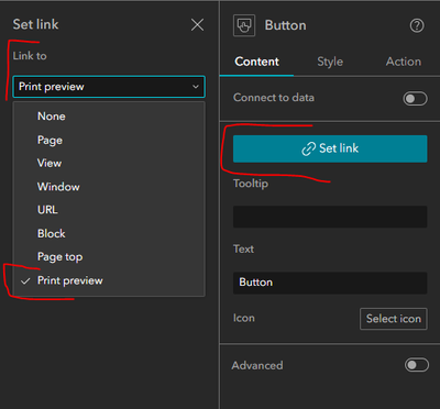

AlixVezina
@ALV The Button widget provides the option to Print the current page leveraging the browser printing tool. This may work for your workflow as the user would be able to print everything they currently see on their page (the profile, the map, and any other element you may've included)?
