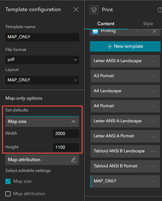

In the print widget for Experience Builder, please consider adding the width and height values as configurable settings that we can change.  Currently, the default settings are Width = 800 and Height = 1100 for the MAP ONLY option.  This makes sense that it produces a portrait printout...but the reality is if we want to print MAP ONLY then we probably want to see what's on our screen.  Most people have their screen oriented in a landscape view not portrait.
So, allowing us to change the default settings would be very helpful.

Hi @NicholasBarger ,
If you want to change the default size of the printed map, you can update it in the MAP_ONLY print template settings:
Shengdi

Hi Shengdi,
I thought I had checked there...but maybe I didn't.  Who knows.  I left out a key piece of information in that we were using the developers edition.  The most current version of Developers Edition does have this setting as well.
