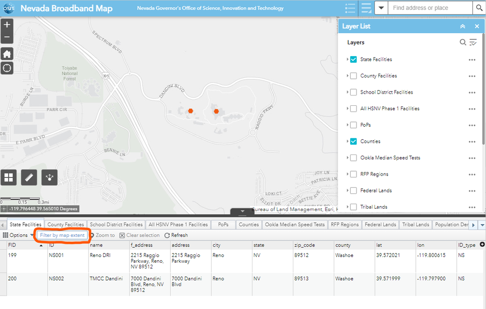

Add Existing Filter Table  by Map Extent functionality to Experience Builder.
I have to say, it is disappointing that ESRI puts out a replacement application that is inferior to old application (WebApp Builder). There are so many basic tools lacking in EB that it is hard to transition to it.

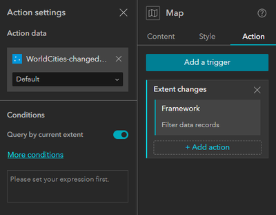

Hi @lzk222 ,
You can add an Extent changes message action to the map widget.

@ShengdiZhang this is good to know, thanks. I don't necessarily want this as the default behavior. I would like the user to have the option to filter based on extent. It's my understanding that setting this trigger is permanent and would give the user no optionality on table results.
Additionally, it is not realistic time/effort wise for me to add these triggers for dozens of tables across dozens of maps. I believe a simple non-trigger solution (button) would be a robust table widget enhancement .
Please revert the status of this request. I would like to see this implementation as a button option as shown in the WebApp Builder that gives user control rather than something that is hardcoded in the background. The code clearly already exists. I don't think it's too much to ask to have this integrated into ESRI "new and improved" map UI.

In ExB, the Table Widget has no "filter by map extent" button or even an extent change trigger. The recommended workaround is to set up a "record selection change" trigger in the Table or filter Framework by extent on the Map. Those workarounds are limiting, confusing for users, and don't provide a spatial query of all the data layers in a visible extent.
