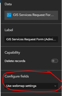

I recently learned a work around for this option - it's not ideal but it helps. If you add a webmap that contains the layer you want to use to your Data tab in Experience Builder (EB), you can then select "New Editable Source" in the Edit Widget and select the layer from your web map. Under "Configure Fields" you will then see an option "Use Webmap Settings" (see snapshot below). In your webmap using the new map viewer, you need to configure a form using the Form tool (see snapshot below) for the layer you are using. In the Form window, you will be able to set properties for each field. For text fields there is a multiline option under "Input Type". This creates a slightly bigger box that allows the text to wrap. It also allows you to expand the box to the right when in Experience Builder, but that doesn't really work well. Ideally you would be able to expand the box down within the Editing window in EB. Ideally, you would not have to jump through all these hoops and would be able to select multiline in the EB Editing Widget and indicate how big the box should be so large text fields could be viewed better.
WARNING: If you already have your app all setup and have actions, you will likely need to change all the widgets over to the webmap layer I think. I basically had to recreate my whole app to implement this 😞
