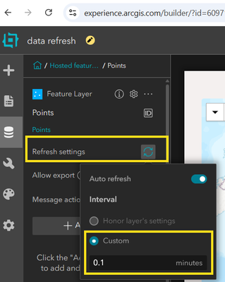

1. Set the refresh interval for the ds in the Data panel.

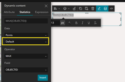

2. Add a Text widget and connect the ds used in step 1.

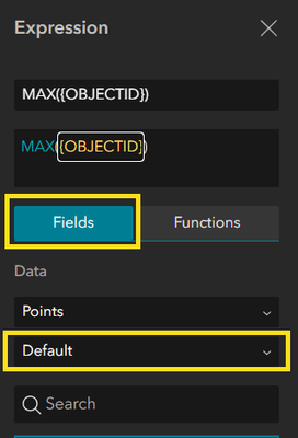

3. Insert an expression. Such as getting the maximum OID. Please note that we should use "Default" here.
If you use Expression, please also select "Default" first, then insert the field.
