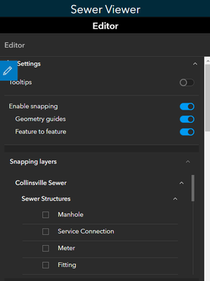

With the latest release, the Edit Widget has come out of Beta and Snapping capabilities have been enhanced. I've found the enhanced Snapping capabilities to confuse our users and fluster them. There's too many options about things they don't care/should be thinking about. I would really like to see the snapping function and what to snap to be something we the builders configure on the backend.
1. It takes up unnecesary real estate.
2. It unnecessarily flusters the user.
3. Web apps are for (at least for me) built for people who are not GIS users and need something really, really simple. If they were GIS users and wanted all the options, they'd be using Desktop GIS.
Please like my idea people or add some feedback so we can constructively move this forward.

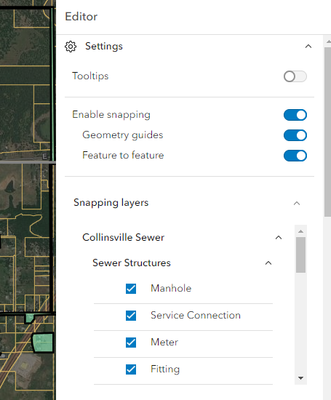

As a side note, I noticed the snapping options in Map Viewer Forms and Experience Builder are different. If we can't hide the snapping functions on the backend, could we at least make it clearer on the front end? If multiple layers are turned on at once, then the user has a whole lot of snapping options to choose from.
Map Viewer Edit
Experience Builder Edit widget
Video here
ExB doesn't have the group layer names like Map Viewer Edit does.

Would it be possible to allow for default layers to be set along with the snapping preferences, so that the user doesn't have to go in and re-select the layers every time?
GISUser74305830
I agree. Also I would like to be able to set Snapping settings just once in the Web Map and then have those settings preserved in ExB every time the user loads it. Right now the user has to check all their snapping layers every time they refresh the map. Unless I'm missing something ...
Snap Settings in Map Viewer:
Snap Settings in ExB:
