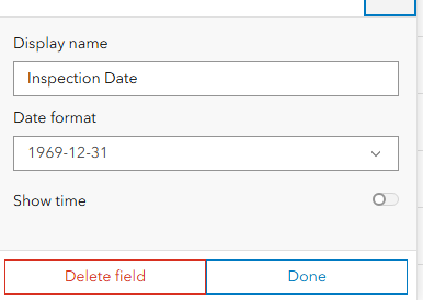

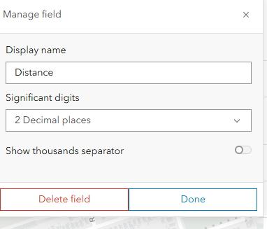

When using WebAppBuilder to create an app you style pop-ups and these carry through to the smart editor window. This includes date/time displaying date only, the number of decimal places to show, and which fields to display.
I have created a map using the 'new' webmap viewer. I have edited my fields to display date/time as date only (and no we cannot use the new Date instead of Date/Time we find it isn't compatible). I have edited a numeric field to only display two decimal places. In pop-ups I have edited which fields are visible and their order. I have adjusted the alias settings for all of these fields.

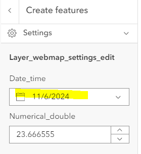

When I use the editing widget in experience builder none of those choices have been honoured. I have switch from "Use webmap settings" to "Customize" and choose my fields and field order once again. None of the date/time and decimal settings have been recognized and I have no option to adjust the date/time and decimal settings.

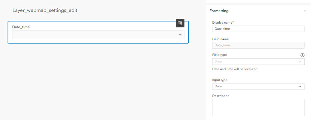

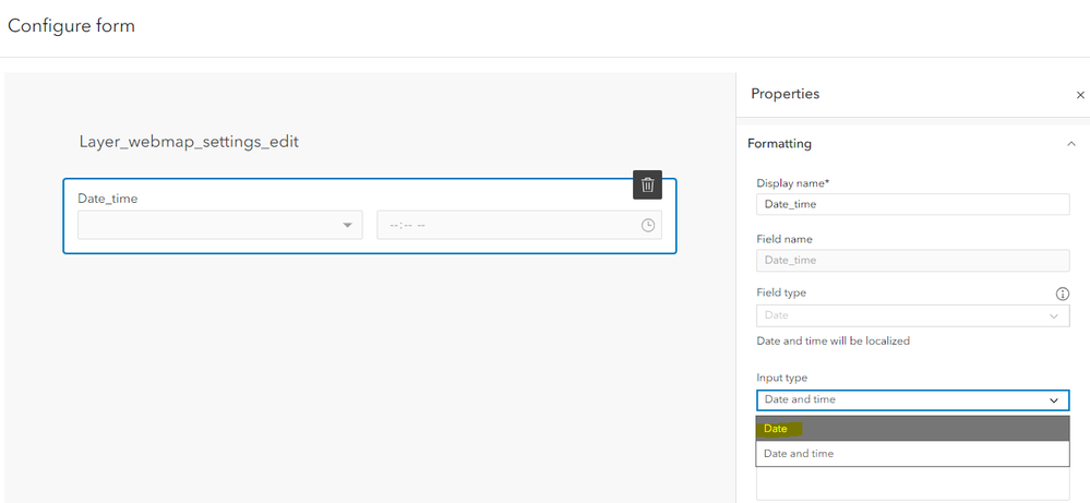

I think you may need to configure Forms for editing the attributes for your layer. You can configure Forms from Map Viewer. Just like the Field and Popups options, you'll find the Form configuration on the right-hand toolbar in Map Viewer.
Within the Form configuration, you can further customize how field values are collected.
For example, for you date time field, you can specify to only collect the Date information in the editing attribute form.
So now when you create new features, it will only ask for the Date and not the time.
It appears there may be a limitation where the number of collected decimals is not restricted while editing. This could be an idea/enhancement request for Forms. I'd recommend logging that request in the Field Maps community (that team builds the editing Forms functionality).
