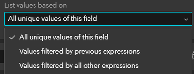

TonghuiMing
@JavierMadoz1
For your first case, I think the scenario varies depending on whether you'd like to make the current list affected by others, which should be as expected (otherwise it would look like a bug):
For the last two points, yes - it would be a valid ENH, to support the Pill selector for predefined values.
Thanks for the feedback.

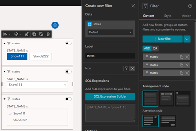

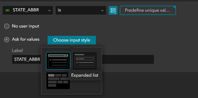

TonghuiMing
@JavierMadoz1 Predefined values, along with other sources, now support three input styles, with the latest AGOL Oct release:
