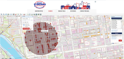

Bec
I agree with the many commenters above me.  We need a Buffer Widget for Experience Builder.  It would be nice to have something similar to what they have in the below image for this website: https://property.franklincountyauditor.com/_web/maps/mapadv.aspx

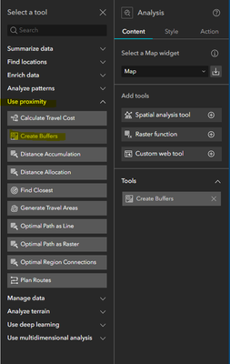

AlixVezina
You can use the Analysis widget to create buffers around features (points, lines, and polygons).
