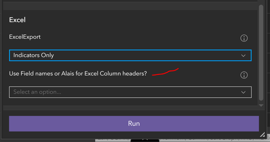

Need a way to hide some parameters when they are not relevant.  Works in Pro but not seeing it work in ExB analysis widget.  I mostly want enabled so I can turn some off params but not sure if other things work or not?  One tool I limit to 1 polygon selected for example.
