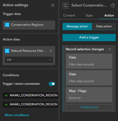

Action Settings on List:
List: Filter Data ActionList: Filter Data Action

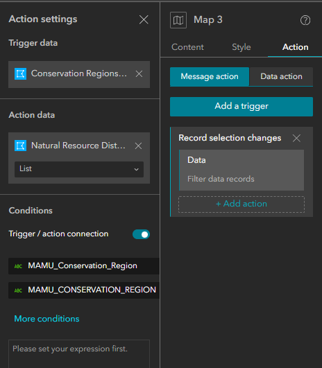

Action Settings on Map:
Map: Filter Data ActionMap: Filter Data Action

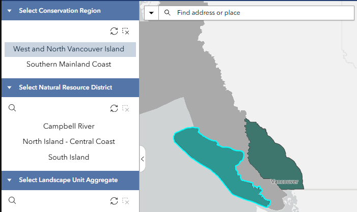

1. Selecting from Region List filters Districts (and highlights Map selection)
1. Selecting Region from List - filters Districts1. Selecting Region from List - filters Districts

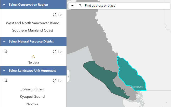

2. Selecting from Map filters Districts, conflicting with filter applied in (1) and leading to No Data result
2. Selecting Region on Map - Filters List, conflicts with filter in (1)2. Selecting Region on Map - Filters List, conflicts with filter in (1)
