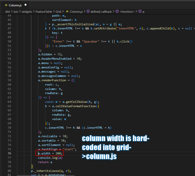

Update:
I figured out the reason why this cannot be changed inside of Experience Builder. The column width has been hard-coded in the Javascript API Column class. I have attached a screenshot. In order to get around this in developer edition, the Column JS code itself must be downloaded and changed. Commenting out "a.width = 200;" within the first function and setting "a.autoWidth = !0;" should make the columns auto-resize based on the contents in the column.

Hello Kari,
I was wondering if you would be so kind as to perhaps let us know where that grid > column.js file resides locally in the latest or near latest version of ExB Developer.
Thanks in advance,
GRMapper
