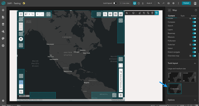

Hi All,
Steps:
1. In Map settings, go to "Tools Layout" and click "Customize".
2. Drag map tools to any of the four corners.
3. For the Overview map tool, go to Map widget settings, open "Overview map settings", and select the position.
Note: This feature is only available in full mode on medium and large devices.
Thanks,
Ke

@Zach-Williams, this feature will be released on ArcGIS Online in February 2026 and ArcGIS Enterprise 12.1.
