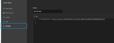

ShengdiZhang
@Pukawai Hi, You can add Arcade data from the Data panel, and then select it in the list widget.
You can find more details at https://doc.arcgis.com/en/experience-builder/latest/build-apps/select-data.htm#ESRI_SECTION3_1DD4154...
