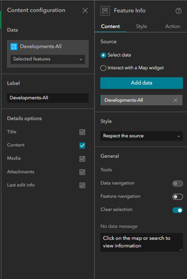

I too have been struggling with the "Clear Selection" limitation.  I think I found the solution (by accident).
1.  Open the application in Experience Builder
2.  Click the Feature Info Widget to configure it (make the Clear Selection toggle is turned on as well as the Enable data action toggle is turned on in the Data action tab)
3.  Under the Source section, choose Select Data
4. Click the Add Data button
5.  Click Select Data
6. Select the layer that you want features selected from
7. Under the Data section, choose Selected features (Default is the default)
Now, when you select a feature on the map (or search for a feature), you can use the Clear Selection button located in the Feature Info Widget to not only clear the selection from the map but also clear the information displayed in the Feature Info Widget .
BenClark
Which version is that screenshot from, @BobCarberry3? I'm working with Enterprise 11.4 and I don't see that option in the Feature Selection widget. A similar function is present in the ArcGIS Online version but it looks slightly different from your image.
BobCarberry3
BenClark, I did this in AGOL, not Portal.
