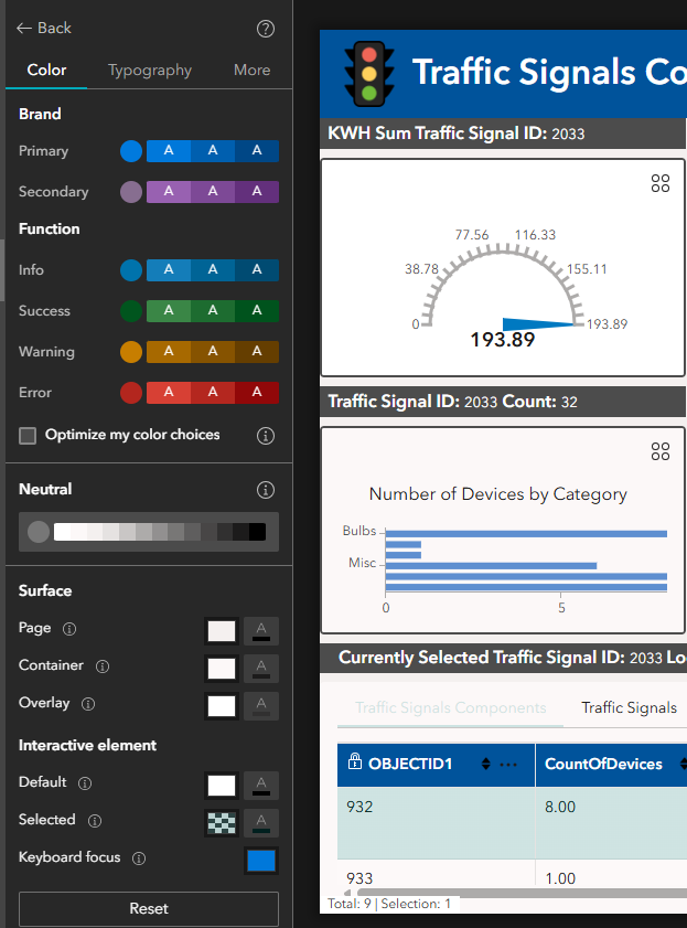

Shen_Zhang
Hello @KatieQuantrell, you can change the table selection color using the Interactive element – Selected settings. The selected fill color is tied to the Primary color setting, so it updates automatically when you modify the primary color — that might be why you missed it out.
Both the row selection color and the selected text color follow the Selected settings, and you can adjust them as needed. Please note that the Selected setting is a theme variable, so any changes will apply globally across Experience Builder wherever it’s referenced. For instance, the selected sheet text in the table also follows the selected color - and I'm afraid it's not possible to modify them seperately at the moment.

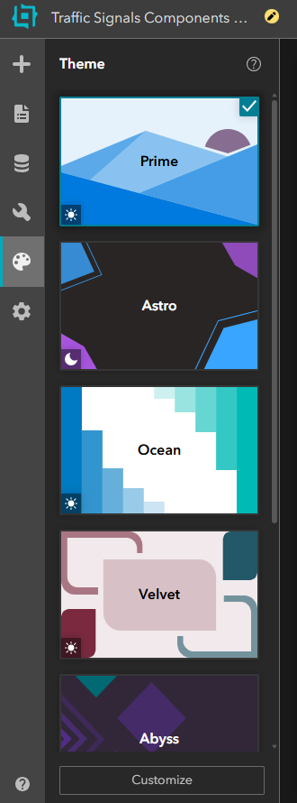

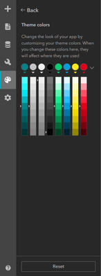

Hi Katie Quantrell,
When you are in Experience Builder it will be on the left side.  Click on the Theme icon, then click on Customize.  The Color tab within the Customize panel is where you can change your selection color for the table by going to the section called, Interactive Element, and changing the color for, Selected.  Hope this helps!
Theme Panel open with Customize showing at the bottom.Theme Panel open with Customize showing at the bottom.
Color tab open in Theme Panel with Selected color changed to light blue for table.Color tab open in Theme Panel with Selected color changed to light blue for table.

Shen_Zhang
@KatieQuantrell, are you working on an enterprise environment? If so, the new themes won’t be available until version 12.1.

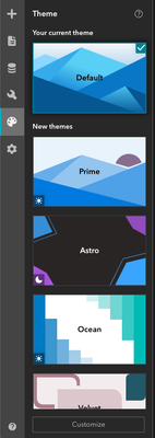

ajohnson
@Shen_Zhang
Hello,
I am running into this same issue as well and I am working in AGOL. I am not seeing all those advanced theme options. What am I missing here?
Shen_Zhang
Hi @ajohnson, if your app was created prior to October 2025, you'll need to switch to one of the new themes. Please note that switching will reset your existing theme settings, and they won't be carried over to the new theme.
