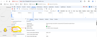

The three empty boxes are Zoom and Home tools in the Map widget. ArcGIS Enterprise 11.5. I tried ArcGIS Experience Builder developer version 1.19 an 1.20, and saw the same empty boxes issue. If I use the hosted ArcGIS Experience Builder in ArcGIS Portal, then I get the normal Zoom and Home tools. Why?
JJChen
I will call the Technical Support tomorrow.
Jianxia
@JJChen, thanks for letting us know. ArcGIS Enterprise 11.5 should work with the dev edition if you just import the app from 11.5 to the dev edition. Could you please share the support case for us to follow up? Thanks!
JJChen
@Jianxia The ESRI case number is 04173576. After our GIS administrator turned on the option "Allow anonymous access to ArcGIS Portal", and removed the domain https://js.arcgis.com from the trusted server list in our production ArcGIS Portal, every thing is working now. Thanks
