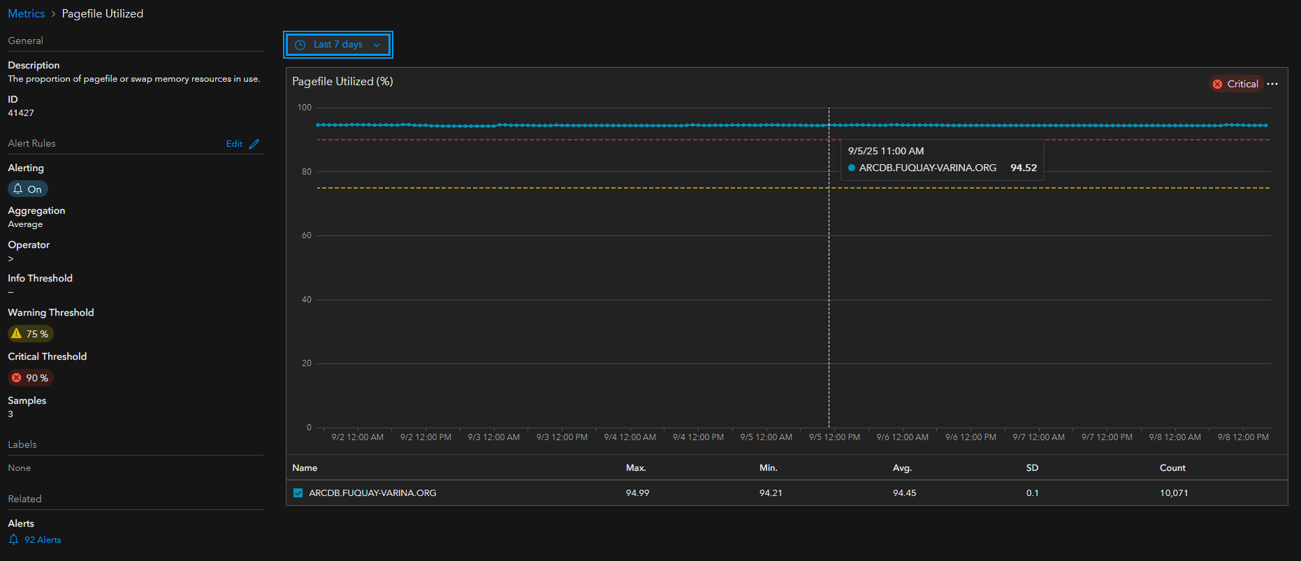

First and foremost, we are not experiencing any noticeable degradation in performance. Everything is running smooth. However, I did notice that Windows' pagefile utilization on the postgres machine is ~95% persistently, so I'm generally just asking if that's normal or expected? Should put it out of my mind, or is this something I need to address?

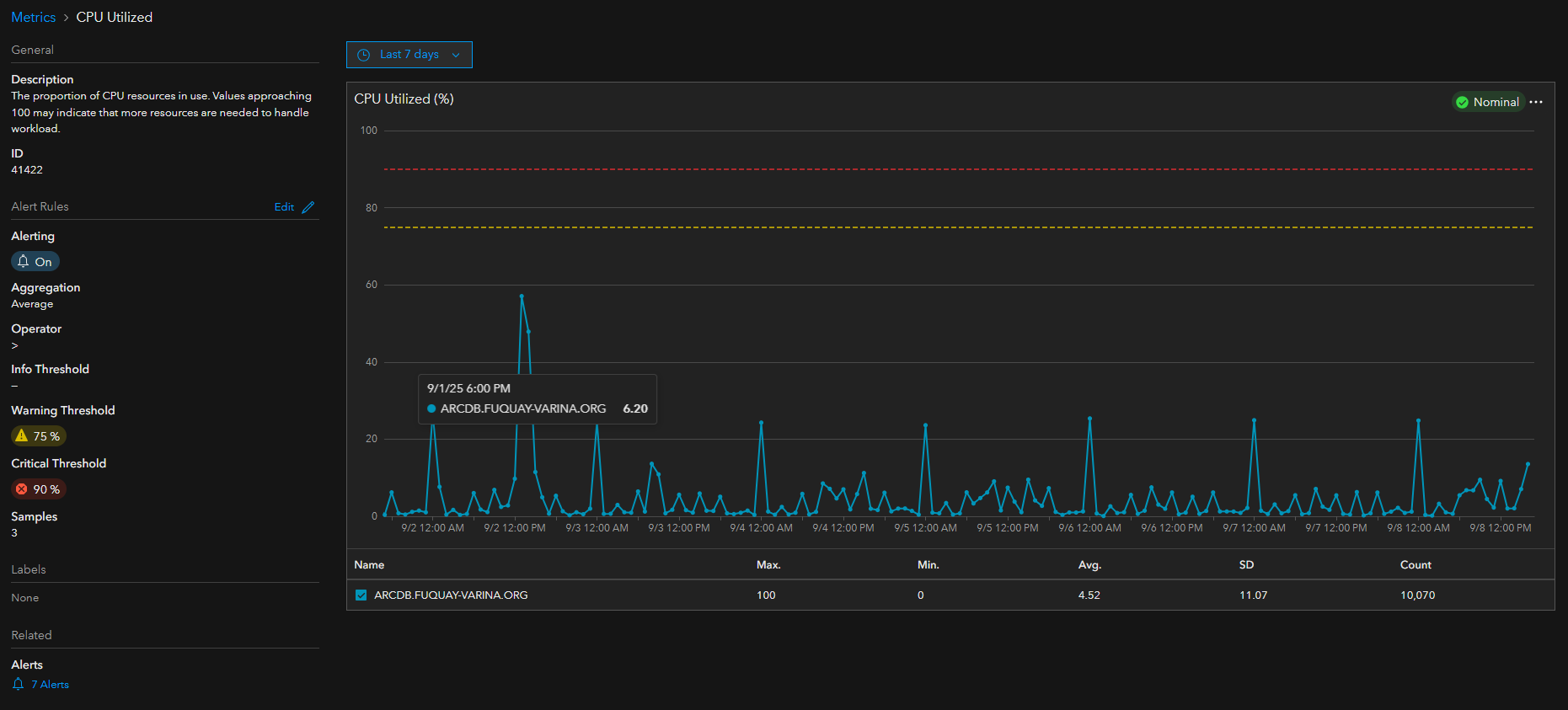

All that is to say that we don't have an extreme burden on the  postgres server. It runs pretty cool between 5-20% CPU with a few sustained few spikes to 40-50% (never seems to get saturated).

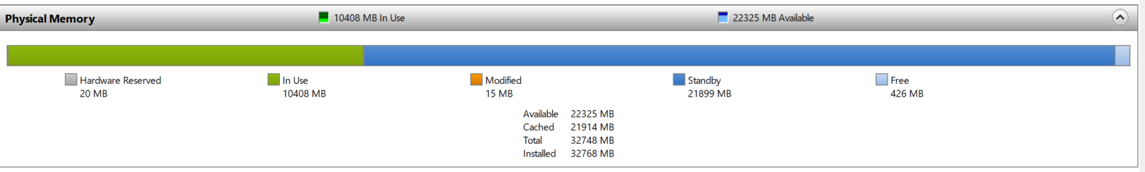

About 30-40% of RAM is persistently 'In Use' with nearly the rest of the RAM is listed by windows resource monitor as on 'Standby'.
Since so much RAM is available, I'm wondering why Windows (or postgres) isn't 'releasing' the pagefile, if that's the right term? Is it normal for postgres to reserve that pagefile for use? Windows is set to manage the paging file size automatically.

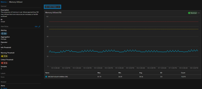

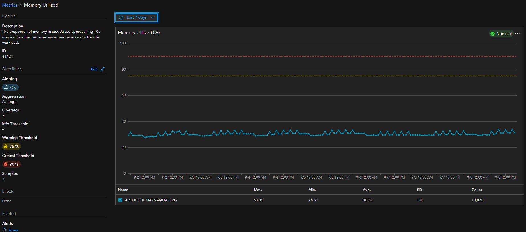

The machine has been through at least one reset recently but the pagefile persistently is 'utilized', according to ArcGIS Monitor metrics. This Monitor alert is how I realized there even may be an issue, otherwise I would not have thought to check on the pagefile since we are not having any performance issues.

High pagefile utilization does not necessarily indicate a problem. To understand whether it's a concern or expected behavior, it's important to explore how Windows handles system-managed pagefiles and what factors may contribute to high pagefile utilization.
Why does Windows use the pagefile even with plenty of RAM?
Windows reserves space for the pagefile regardless of available physical memory (RAM) to ensure system stability and to accommodate system crash dumps in case of failure.
For system-managed pagefiles, Windows dynamically manages the pagefile size based on system demand. However, it’s important to understand some of the rules Windows follows:
  • The pagefile can grow up to three times the amount of physical RAM or 4GB, whichever is larger.
  • It is also limited to one-eighth of the total volume disk drive (C: in your case).
For example, if you have 32GB of RAM but only 100GB on your C: drive, the pagefile size will be capped at 12.5GB (one-eighth of 100GB) for a system-managed pagefile.
How to check pagefile usage
You can check the pagefile’s current usage by running this command in Command Prompt or PowerShell:
wmic pagefile list /format:list
This shows both the allocated size and current usage of the page file. You can calculate pagefile utilization using the formula:
System-managed pagefile and dynamic allocation
As noted earlier, AllocatedBaseSize can change dynamically based on system demand for system-managed pagefiles. One factor to be aware of is the system commit charge %, which you can view in Resource Monitor. The commit charge represents the total amount of virtual memory (physical RAM + pagefile) being used by processes. When the commit charge approaches the system's commit limit (usually around 90%), Windows will expand the pagefile to provide more virtual memory. If the commit charge exceeds 90% without the pagefile size growing, it may be worth investigating further to ensure it's not hitting one of the earlier mentioned system-managed constraints.
What happens when virtual memory is saturated?
If your system’s virtual memory is being heavily used, you may start seeing warnings about low or out-of-memory conditions. This can lead to application or service failures, including crashes of components like your postgres database. You can check for errors in Event Viewer logs. When virtual memory is exhausted, Windows will log events, typically with Event ID 2004, indicating low virtual memory or out of virtual memory conditions. These events are typically logged in the System logs and may look something like this:

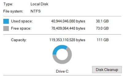

This machine has ~111GB of C:\ disk space allocated, currently at ~73gb free. So it seems the 1/8th cap (~13 to 14gb) you described isn't being hit. (EDIT: however, virtual server clusters can be weird, where although it has an 'allocation' of 111GB, it might not actually have that 'dedicated' to it on the server node unless the machine actually uses it all. Not sure if that could have any relevance here).

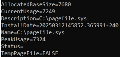

Here are the results of the wmic pagefile list /format:list command
I checked Event Viewer and it seems there are no System log entries relating to low virtual memory condition. I tried manual review, and also specifically filtering for Event ID 2004 in the entire history, but I didn't come up with anything. I also filtered for all warning/error/critical level events and thankfully found nothing of note that has any relevance so far that I can tell. So that seems good that windows isn't screaming behind the scenes!
Your note on the dynamic allocation base size is interesting though. It seems in theory, since my utilization remains above 90%, and that I haven't hit a cap of either 1/8 the hard disk volume, or 3x the physical RAM, that it should be automatically expanding the base size in my circumstance? But since there are no System errors being logged, it's not actually hitting a cap in a way that causes issues?

When I mentioned >90%, I was referring to commit charge %, not the pagefile utilization %. In Resource Monitor, go to the Memory tab and check the Commit Charge graph (see reference image below). This shows the total memory (physical RAM + pagefile) that has been reserved by Windows processes. If your commit charge % exceeds 90% and you're seeing high pagefile utilization without the allocated size growing, then you could probably resolve this by either increasing the capacity of your C:, or moving the system-managed pagefile to another volume with greater capacity.

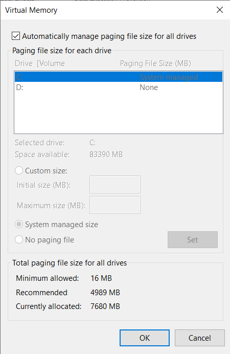

Ah hah, thank you for clarifying. Here is the commit charge level from resource monitor.
I think you've helped me exhaust the necessary steps to confirm things are fine. I'll consider this issue resolved and make sure ArcGIS Monitor doesn't scream from that pagefile metric on this machine. I appreciate your detailed answers, thanks again!
