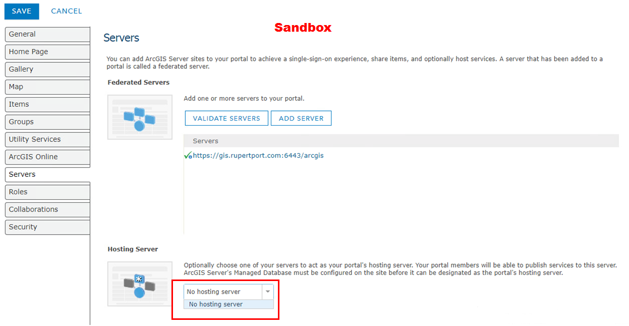

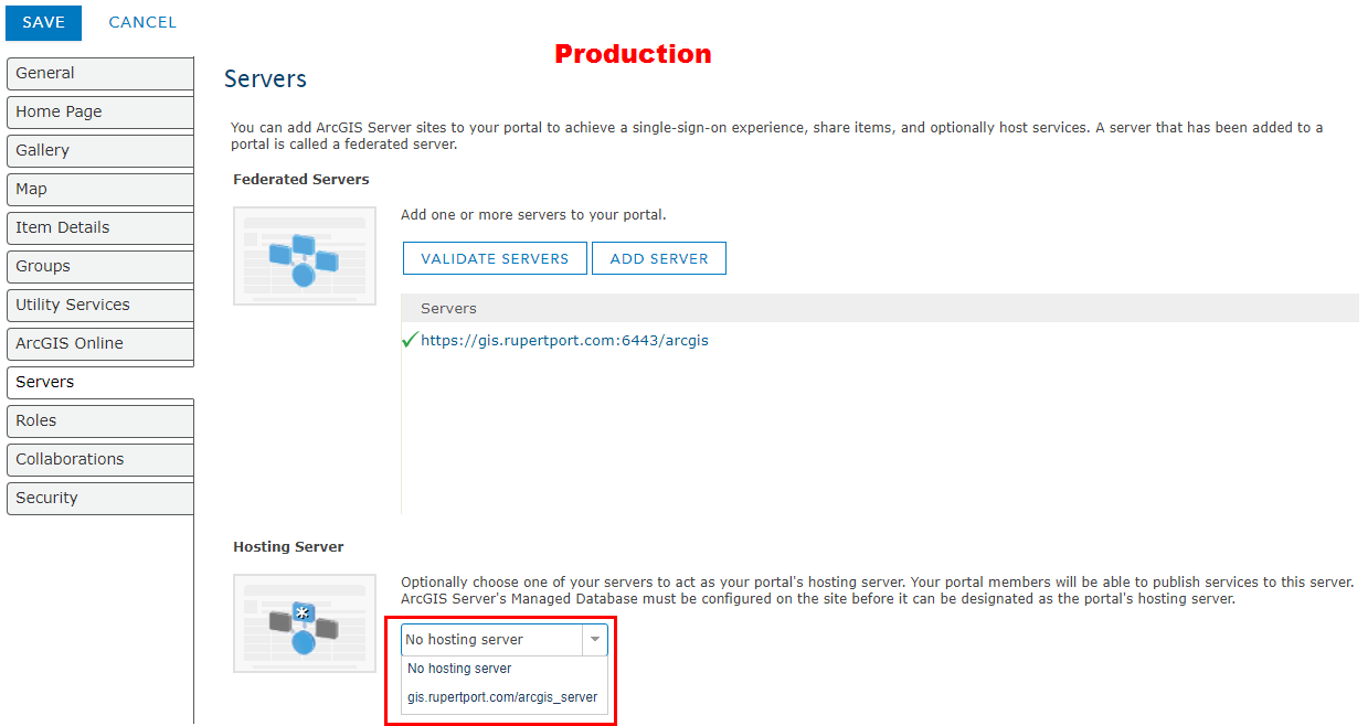

I'm in the process of implementing ArcGIS Data Store, and a part of that process involves first designating a hosting server.  I have just upgraded everything on our Sandbox to version 10.6.1 (ArcGIS Enterprise and ArcGIS Desktop).  I am going through the steps on our isolated sandbox server first in case I blow something up.  When I get to the window in Portal for ArcGIS (Organization ► Edit Settings ► Servers), the drop-down under "Hosting Server" is empty.  However, when I review the same drop-down under Hosting Server in our production environment, an option is available:
The Sandbox is supposed to be an exact copy of what is in Production...so how could there be a discrepancy?  How do I ensure that there is indeed a Hosting Server option here?  From where is Portal retrieving this Hosting Server path?

I'm guessing that the federated Server in your sandbox environment either doesn't have a relational ArcGIS Data Store registered (anymore, perhaps), or it's not validating. Take a look at the data stores first through Manager or the Admin API and make sure that you can see the ArcGIS Data Store registered and it validates.
