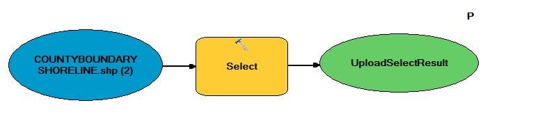

Hi.  Does anyone have any insight into why a particular, simple, GP service would crash ArcMap when I execute it?  The service performs a select on an uploaded shapefile and returns the selected features.  It publishes without errors, I don't see anything in the ArcGIS server log.  And other similar gp services work fine.   I'm stumped.  This one looks like the following.  I've recreated it a couple of times.  I've tried it with a query statement and without.
This is using AGS and ArcMap 10.3.1.
Oh, and it is fine when deployed in my sandbox environment, for what that's worth.
Thanks.

MaryEllen_Perko
Hi.  Thank you so much for the continued help on this.
Before I answer your questions, I have tried two things that seem worth mentioning:
  1. I converted the uploaded shapefile to a file geodatabase, didn’t change anything else, and published the gp service.  As a result, ArcMap no longer crashes but the output is empty.  And it shouldn’t be because I’m not actually selecting anything in the SELECT tool, so all features should be returned (and are when I execute the tool locally prior to publishing).
  1. I deployed a another gp service that uses only the SELECT tool but uses a different shapefile and got the same ArcMap crash.  I then converted the data to a file geodatabase and deployed it and it also returns an empty dataset, but no crash.
Both of the data sets (as shapefiles) work fine when used with different tools, like "select by attributes" followed by "create feature class."
Also, we have a pretty distributed installation of AGS components so something could be misbehaving just about anywhere.
To answer your questions:
~ I've tried the tool on just one other machine and it crashed there as well.
~ I'll need to check on the graphics card, but other similar services have no problems and I've got a pretty good workstation that is configured for GIS development.
~ I have executed the tool as the first thing I do after opening arcmap and it crashes.
~ I don't think I have 3rd party tools installed, but could you provide an example?
And yes, I'll send you one of the dmp files shortly.
Thanks again.
Edit:  Something else I'd like to mention - Because I was able to successfully retrieve features through the rest point, I added the gp service url to an agol web app builder GP widget and the tool works just fine.  I don't know what that means, but thought it might be important.
